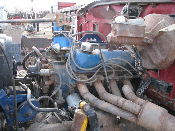

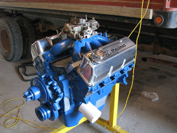

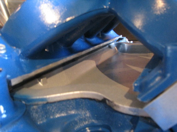

Ran into a snag over the weekend, the water pump i got from summit ended up having a bent impeller, so i gotta send it back and get the pump replaced, but i have a stock one i'll run in its place for the time being, got the covers and the pulley and the wires i needed so i'm good to go on that front. I did some surgey on the intake as i was afraid of having water sitting underneath it and the the valley pan from pricemotorsports, so i chopped the bottom of the intake out, other than that i wasn't able to get the motor dropped in, but the old motor is ready to get yanked, just have to seperate from the tranny and pulled on it out.
I ordered a few more parts as wll, i ordered a new lakewood bellhousing thats sfi approved for exploding clutches , also have an external oil line kit from price motorsports coming as well, then i will still need to port the headers for the bigger ports, do some cleaning and painting and i'll be good to go to drop the new motor in and fire it up, i'm hoping that since i have a short little holiday this weekend i will be able to get everything up and running. A few pictures:
the old:
the new:
the mods to the intake:
