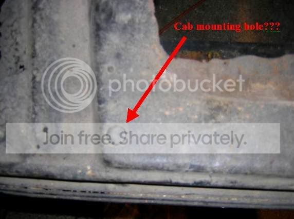

Thanks for the information! Here is what I have...
This is a shot from the top of the floor in the rear corner. You can just make out a spot where a hole was welded in. I believe this is where the rear cab mounting bolt went.
It's more visible on the bottom. This photo is from the center of the cab facing outward.
As my cab is mutilated, can you tell me how far over the brace/bracket under the floor extends toward the middle of the cab? I can tell the 1 3/4" wide brace goes all the way across, but the shorter one that goes all the way to the corner appears to stop somewhere in the middle of that big void.
Here is what appears to be another mounting bolt hole, but it has a plug in it that appears to have been there for awhile. Is that normal? Would there normally have been a bolt there? I believe this is the bolt that I have seen in some of the gallery photos, but I'm not sure.

My cab is still laying on its side where I'm finishing the welding, so I can still maybe give you some measurments. The Channel that extends across the back is 49 1/2 inches long give or take a 16th inch. The corner pieces are under each end of the channel as you can see. They only extend 1" past the center of the mount hole on each side so they aren't very long.
Picture #1: The mount hole on mine is 9" toward the center measuring inside the cab from that plate sticking up behind the seat riser bracket shown in the picture
Picture #2: Its hard to tell exactly but I don't think this is a mounting hole. put your tape against the inside lip of the corner plate, the mounting hole is 9-1/2 inches inboard give or take a 16th inch.
Picture #3: Catch the end of the channel with your tape and measure toward the center, the mounting hole is 9" to the center of the hole
Picture #4: This is not a mounting hole. I don't know what its for but it has a plug in it. I think its a locater hole used in mfg.
Picture #5: This is not a mounting hole also because it also has a plug in it. Measure from the inside edge of this plate. The hole is 1" to the center of the mounting hole. There is a block of wood that fits crossway inside this plate. There is no cross channel brace here.

Thanks! I measured all of the locations the other night, but I didn't write them down. I'll have to go re-measure. The (filled-in) hole in the first 2 photos is the same hole - one from the top and one from the bottom. The same goes for the last 2. I'll try to get back out to the garage after the kids go to bed.

Made it back out to the garage. The holes in the pics are spaced 41.5" apart, across the cab. If the cab mounting holes were 9" from the edge, it would have been in the area that is cut out. Thanks for that information. I have a better idea now, what Ford used for mounting, so I can make sure I have at least as good a system.
