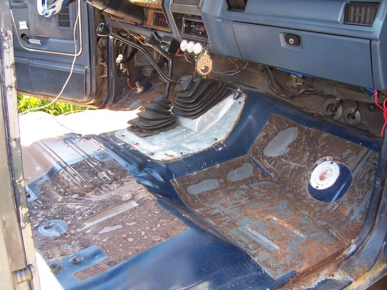

More progress made 06/29/2007
I was able to take 1/2 day off today and finally get the sound deadending tar out. At first I was using a razorblade type scrapper I had laying around...too sharp for the job. I got the best results from a plain scrapper/putty knife and a hammer. It did wonders and only took an hour and fifteen!
Just use the putty knife and a hammer and work your way through the tar. You will not get the tub completly clean...more on that coming up!
Here is waht it looks like once the tar is out. The toughest side was the passenger side...less traffic, hence the tar held up better. The driver side was rusting out underneath just like Roger Dowty explained.
Do yourself a favor and get some of these...sanding wheels for your grinder. These things work slick! I was able to grind off rust and residue on the passenger side in about 10-15 minutes. Probably would have taken my 2 hrs with a typical sander.
Finished product...at elast the passenger side. More to do on the Driverside!
The next step is finish up the driver side and then door removal. From there I will be able to better tell what repairs I will need to do to the rockers where the new ones won't cover. Then sand the outer rears, back end and then Rust Bullet. I need more hands and more time!
