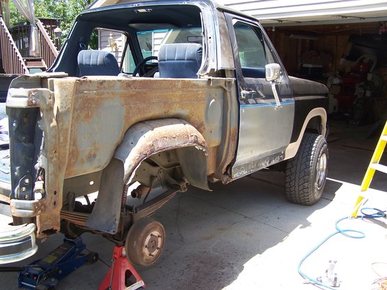

06/01/2007 Progress
Here are a couple of pictures of the cuts you will need to make at the front of your cap:
Hine: my dremel has become a very valuable tool in the arsenal of hand and power tools!
The vertical cut:
And the cut along the seam:

On to the interior...first some helpful hints. Make sure that you thoroughly soak the rear seat hold downs with PB Blaster prior to removal. It will help against carnage. The following tools are very helpful:
When looking at interior removal it is pretty easy. especially after tackling that spot weld job. Just start by removing screws from the trim, trim brackets and carpet hold downs...if you can get a good grip on the screws, don't waste time, just grind the heads off and pop them out. Here is a pic of the carpet hold down where the tailgate meets the body:
Next start removing the rear seat hold downs...these bolts are 3/4":

WOW so that's what the original carpet used to look like?
My plan is to power spray and oxiclean the carpet to see if I can get it back or close to original. I believe VDT offers a dye that I can use to dye the carpet a different color...possibly black. If it does'nt work out, I can alwasy buy some automotive carpet...maybe the sandstone color!
Once all trim, carpet hold downs and bolts (x6) are out you can remove the carpet and cardboard liner:
Next remove the seats...fairly easy...this needs limited explanation...8 bolts in total...for the life of me I do not remember the size. Next remove the seatbelt hold downs (Torx bolt = t-45 to be exact). Remove the front carpet and cardboard liner:
Interior ready for sanding:
I was very surprised to see the tub in such good shape! After seeing some of your tubs on FTE I was a little worried as to the shape of mine! Just a few holes to fill!
The plan is to peel up the tar in the tub, remove doors, sand tub, Rust Bullet and then the rough black liner. May need to take some 1/2 days off work to get some more work done!

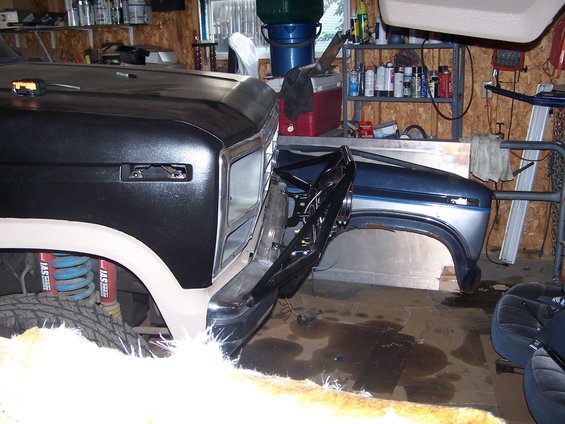

Light Bar Bumper
Hey fellas and gals,
Just a quick update...I'm back to work again...BUMMER! I came home last night and the wife had ordered me the procomp lightbar bumper for Father's Day! What a woman! Anyway Summitt Racing says its only applicable to the 1992-1996 f-150s. This thing will fit my 86 bronco. I already put the lights on it and moutning brackets. I hope tonight to get it mounted.
I was telling Duster Dan when he was up that the ultimate would be to build a "lower profile" thick gauge steel bumper to put underneath it. We will see how tht progresses.
I'll keep you posted and post some more pics soon! I need to steal away some time to do some more work on this thing...I want to have it up and running by mid-summer.

ProComp Lightbar
Just installed...I had a few moments.

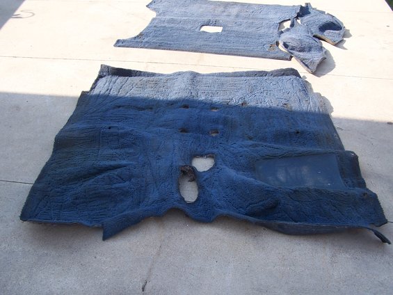

Carpet Cleaning 101
Thought I would post-up on my latest, short-term project. A friend of mine from another forum suggested cleaning my carpets before I consider getting rid of them:
Quote:
Originally Posted by Sixlitre View Post
Xris
As far as the rug not looking original, it could. Try this trick my Scottish Auntie suggested;
works like a charm ! Even using no soap, at all, the rugs pumped white soap foam for 20 minutes and BOY ! did they come out clean !
Read up on it here;
http://www.supermotors.net/clubs/sup...try/4970/19835
Sixlitre
Six - I did the power washing last night. Man I have never seen so much oil in one carpet. I used a little product called Oxiclean on the rear carpet and that, so far, has come out cleaner than the front. I will have to blast them again in a few days. I'll take some pictures of my progress tonight and over the next few days. I have not been given time by the boss to work on the truck further....I had to sneak the stealth carpet cleaning in last night as well as the finishing touches on the prerunner bumper. Thanks for the tips!

Carpet Progress
So as I said before I did a little work on the carpets. Here are some pics...still have some work to do on them. My plan is to mix the Oxyclean into a solution this time, spray, scrub and then power spray a second time. I want to make sure these things are as clean as possible before I use what is called VHT vinyl and carpet dye. The carpets will be black. I plan on using the Krylon fusion + the VHT dye to eventually do my door panels and interior panels.
Some of may be asking. "Why aren't you putting those rear fenders on yet?" The reason I have not started addressing the rear fenders is the fact that I plan on Rust Bulleting the entire inner tub as well as the inner fenders where you see all that surface rust. Then a couple shots of that Black smooth liner in inner fenders. See pics below:
This is after my first power spraying. The rear carpet was treated with Oxylean and came out cleaner than the front.
Here is what I am talking about Rust Bulleting and lining + plus I have to rebuild the inner wheel well.
I was able to start scrapping the sound-deadening tar out of the tub. Every chance I get out in the garage, I'm scrappiong this stuff out:
