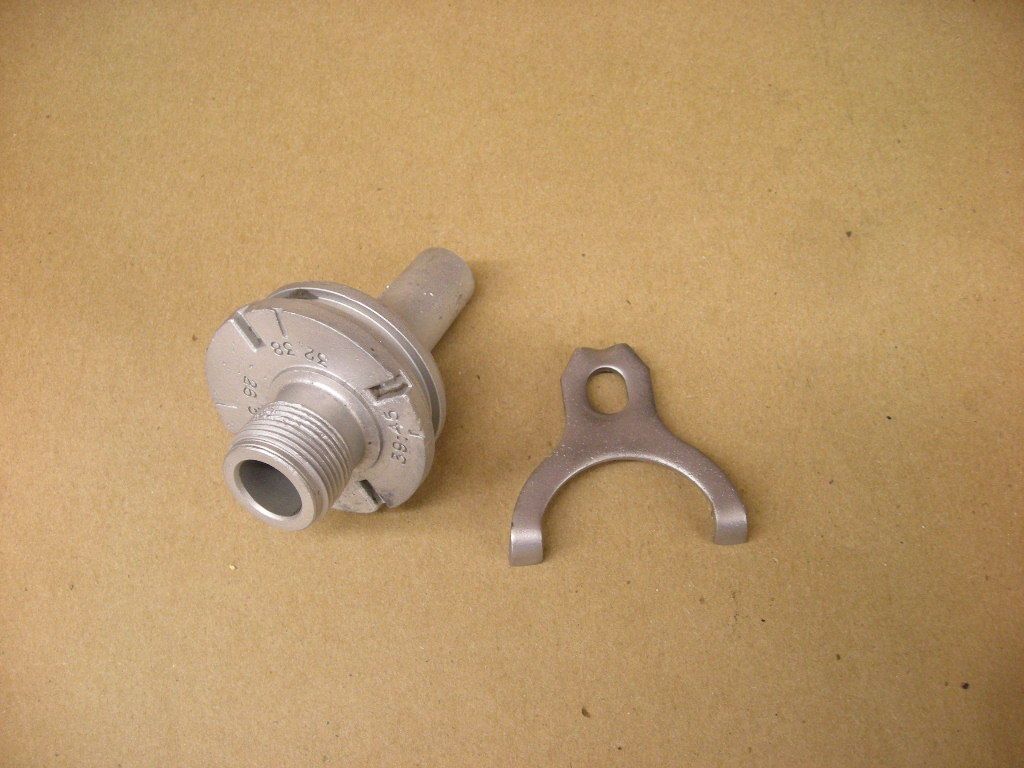

I will take you up on that offer. I have this speedometer gear pinion support pictured. Do I need the long auto trans style or short (Jeep style) speedometer pinion gear? It looks like the short one would work but hard to tell for sure from a picture.
The Dodge speedo pinion gears are available new and used around $28 to $30, and used pinion supports come up on ebay frequently.
