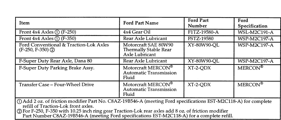

Attachment 170858
From the 1996 owner manual.

Even with a limited slip axle? I've always thought LS always gets the additive. This is my first truck that's had it out of about 6
Correct. The additive is specifically for LS differentials, however, all mainstream synthetic brands have modifiers already...so you don't want to go crazy with friction modifiers if they aren't needed. Many bottles, in fact, instruct you not to add modifier unless you get chatter.
