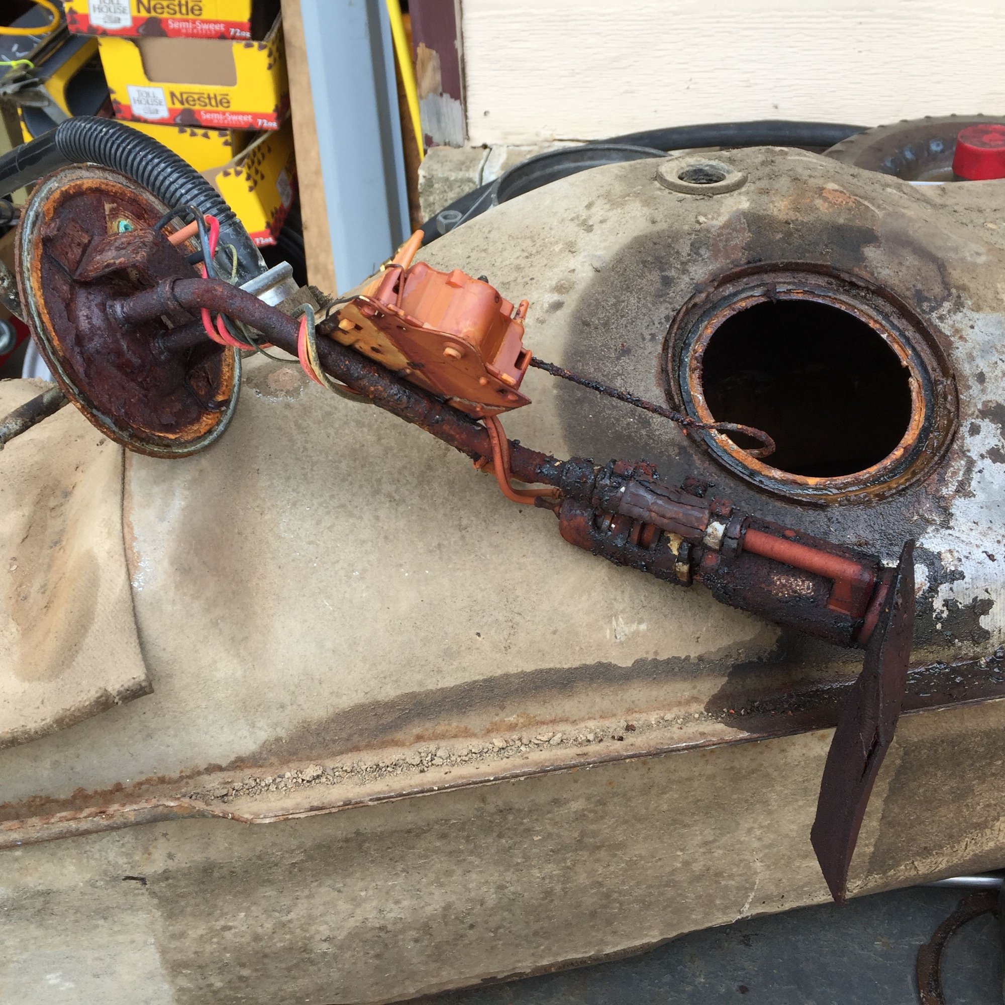

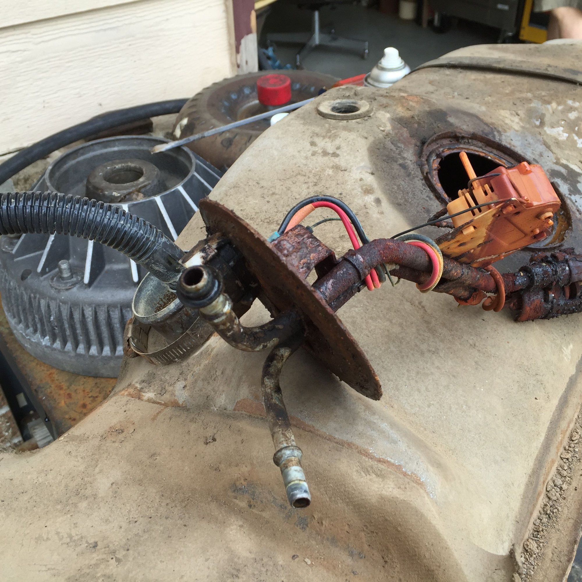

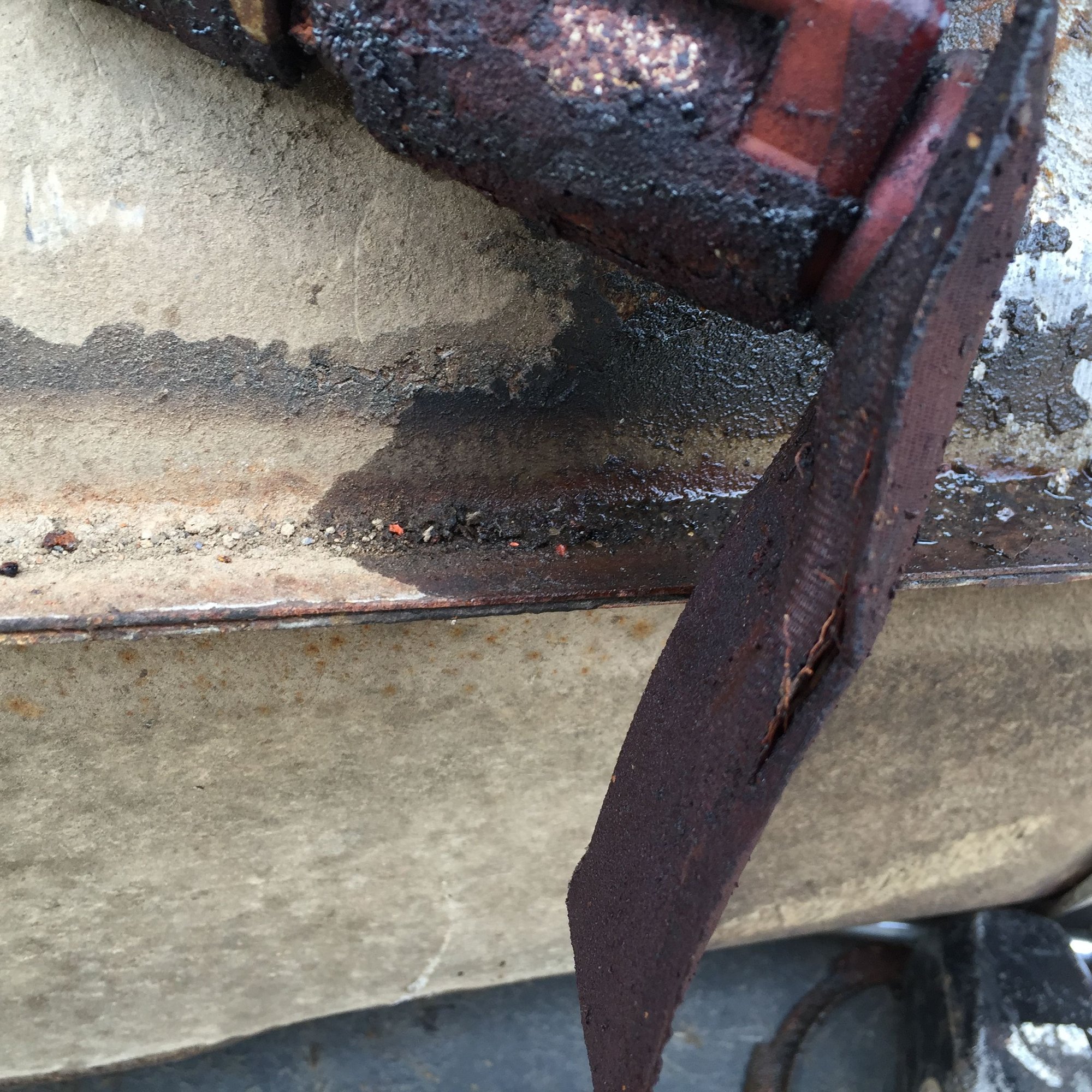

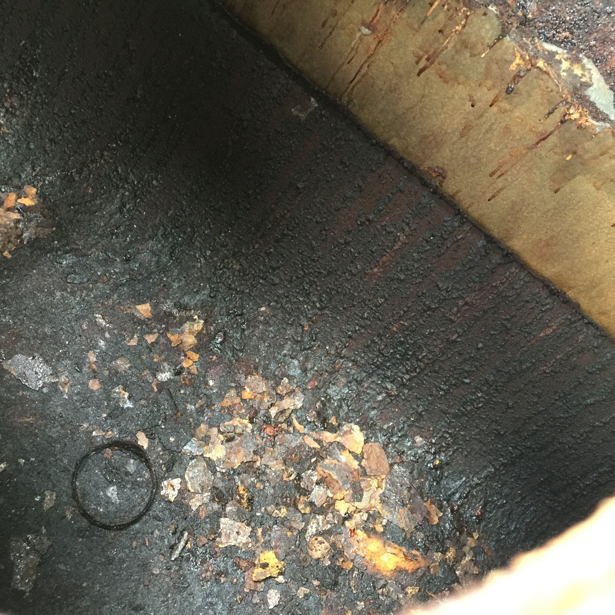

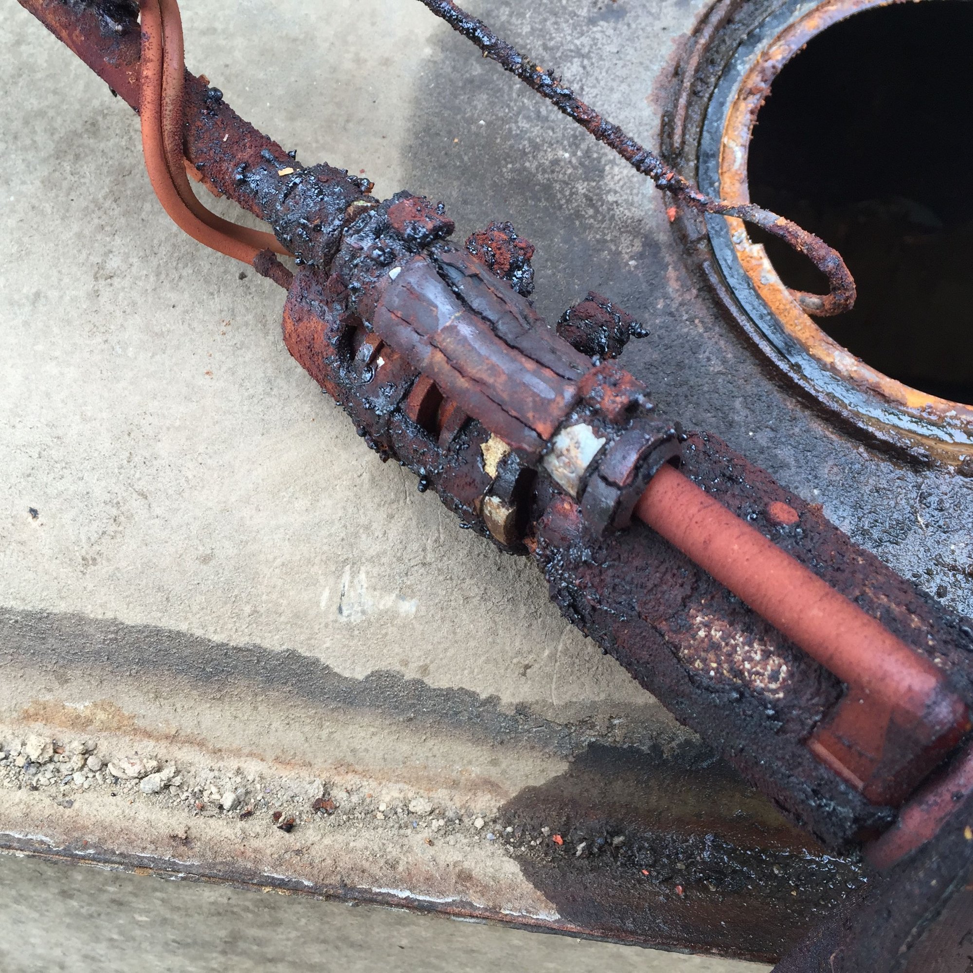

Here are some pictures of what the inside of the old tank and sender looked like:

Judging by the amount of crud in the tank, I'd strongly suggest replacing it. That junk will be working loose for years. Expect the pickup sock to get covered with flakes. Any fines that get past will trash the pump and plug the filter.
