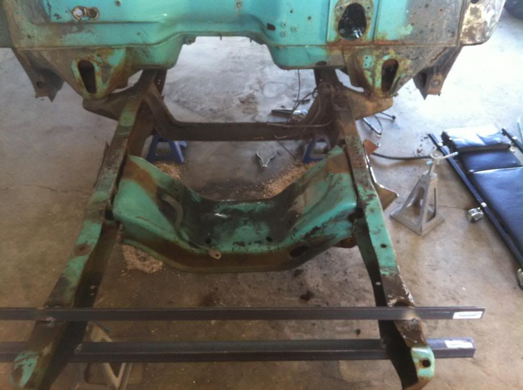

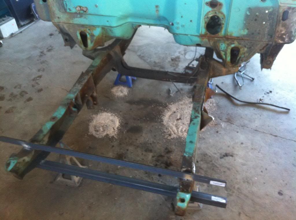

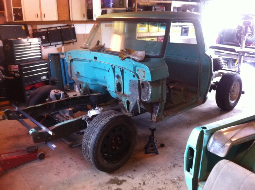

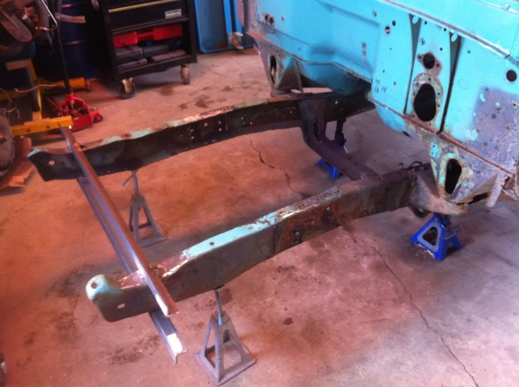

Getting ready to drop the suspension
[IMG]<a href="http://s1172.photobucket.com/user/cccreations1/media/001_zpsa4fadc46.jpg.html" target="_blank"><img src="http://i1172.photobucket.com/albums/r567/cccreations1/001_zpsa4fadc46.jpg" border="0" alt=" photo 001_zpsa4fadc46.jpg"/></a>[/IMG]

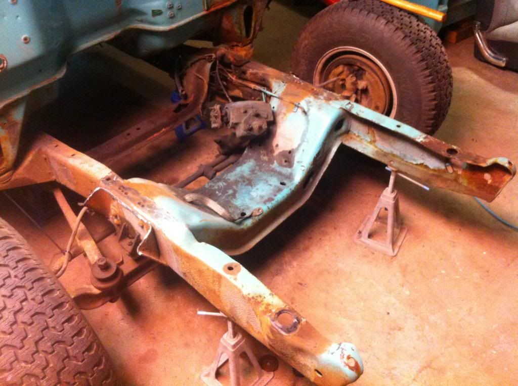

suspension out and starting to mark and cut the x-member
[IMG]<a href="http://s1172.photobucket.com/user/cccreations1/media/013_zpsd19594ec.jpg.html" target="_blank"><img src="http://i1172.photobucket.com/albums/r567/cccreations1/013_zpsd19594ec.jpg" border="0" alt=" photo 013_zpsd19594ec.jpg"/></a>[/IMG]
all cut and starting the removal
[IMG]<a href="http://s1172.photobucket.com/user/cccreations1/media/018_zps78dda9b5.jpg.html" target="_blank"><img src="http://i1172.photobucket.com/albums/r567/cccreations1/018_zps78dda9b5.jpg" border="0" alt=" photo 018_zps78dda9b5.jpg"/></a>[/IMG]
<a href="http://s1172.photobucket.com/user/cccreations1/media/019_zps6a80cad3.jpg.html" target="_blank"><img src="http://i1172.photobucket.com/albums/r567/cccreations1/019_zps6a80cad3.jpg" border="0" alt=" photo 019_zps6a80cad3.jpg"/></a>

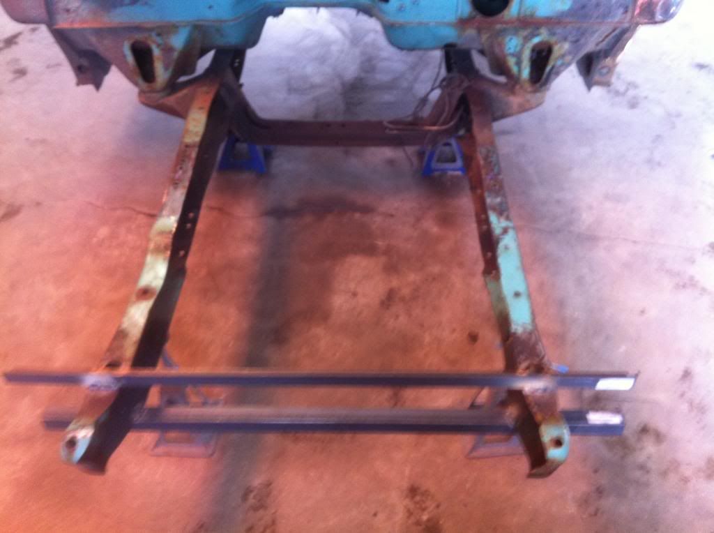

All out
[IMG]<a href="http://s1172.photobucket.com/user/cccreations1/media/020_zpsa9680dc1.jpg.html" target="_blank"><img src="http://i1172.photobucket.com/albums/r567/cccreations1/020_zpsa9680dc1.jpg" border="0" alt=" photo 020_zpsa9680dc1.jpg"/></a>[/IMG]
[IMG]<a href="http://s1172.photobucket.com/user/cccreations1/media/021_zps888d65e2.jpg.html" target="_blank"><img src="http://i1172.photobucket.com/albums/r567/cccreations1/021_zps888d65e2.jpg" border="0" alt=" photo 021_zps888d65e2.jpg"/></a>[/IMG]
[IMG]<a href="http://s1172.photobucket.com/user/cccreations1/media/022_zps97f8086b.jpg.html" target="_blank"><img src="http://i1172.photobucket.com/albums/r567/cccreations1/022_zps97f8086b.jpg" border="0" alt=" photo 022_zps97f8086b.jpg"/></a>[/IMG]
Reply With Quote

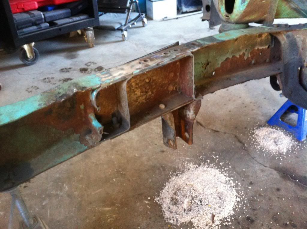

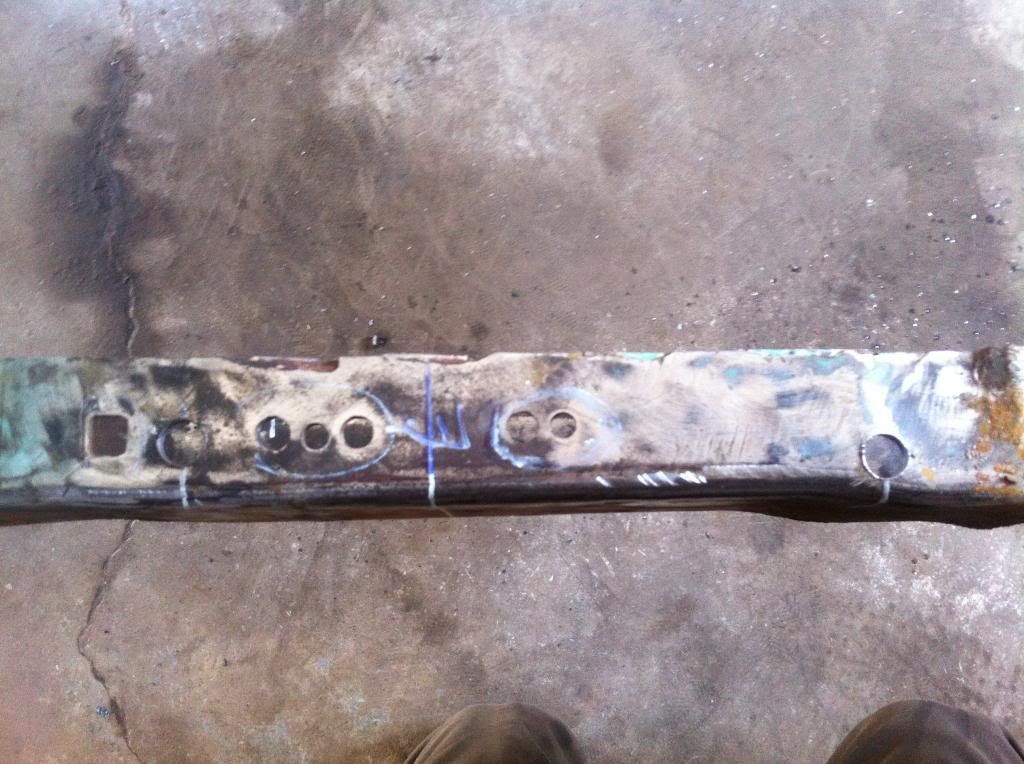

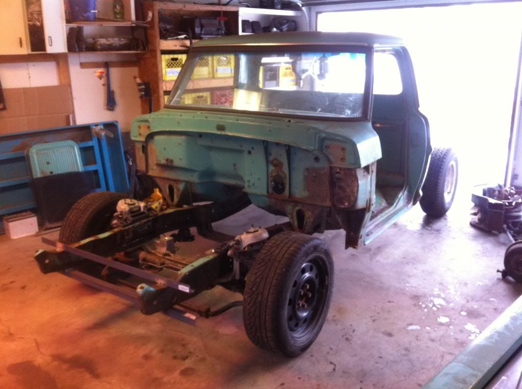

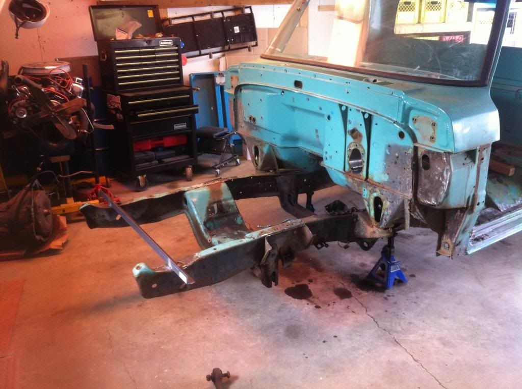

So got the flu last couple days but am back at it now
[IMG]<a href="http://s1172.photobucket.com/user/cccreations1/media/006_zps10088b5e.jpg.html" target="_blank"><img src="http://i1172.photobucket.com/albums/r567/cccreations1/006_zps10088b5e.jpg" border="0" alt=" photo 006_zps10088b5e.jpg"/></a>[/IMG]
removed all the old cross member and shock towers
[IMG]<a href="http://s1172.photobucket.com/user/cccreations1/media/008_zpsd2303f54.jpg.html" target="_blank"><img src="http://i1172.photobucket.com/albums/r567/cccreations1/008_zpsd2303f54.jpg" border="0" alt=" photo 008_zpsd2303f54.jpg"/></a>[/IMG]

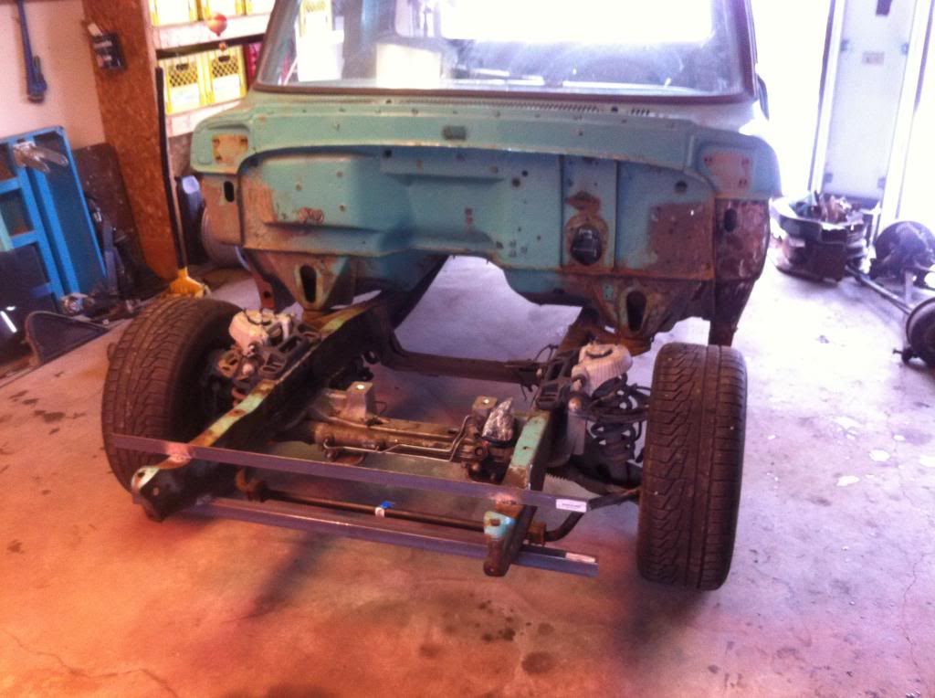

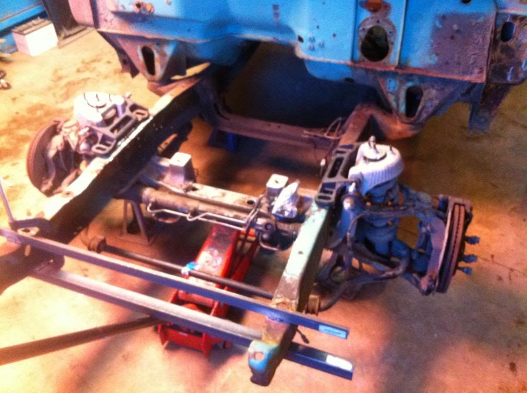

All measured up and test fit the cv IFS
[IMG]<a href="http://s1172.photobucket.com/user/cccreations1/media/011_zps0ddc29a2.jpg.html" target="_blank"><img src="http://i1172.photobucket.com/albums/r567/cccreations1/011_zps0ddc29a2.jpg" border="0" alt=" photo 011_zps0ddc29a2.jpg"/></a>[/IMG]
<a href="http://s1172.photobucket.com/user/cccreations1/media/010_zpsbb23d8b3.jpg.html" target="_blank"><img src="http://i1172.photobucket.com/albums/r567/cccreations1/010_zpsbb23d8b3.jpg" border="0" alt=" photo 010_zpsbb23d8b3.jpg"/></a>
[IMG]<a href="http://s1172.photobucket.com/user/cccreations1/media/015_zpsa3dff9f0.jpg.html" target="_blank"><img src="http://i1172.photobucket.com/albums/r567/cccreations1/015_zpsa3dff9f0.jpg" border="0" alt=" photo 015_zpsa3dff9f0.jpg"/></a>[/IMG]

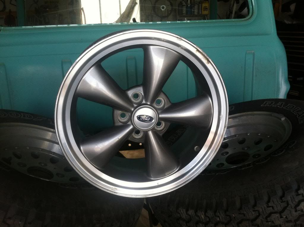

also found some mustang "bullit" 17x8 rims for $180 !!
[IMG]<a href="http://s1172.photobucket.com/user/cccreations1/media/005_zps8db4abe2.jpg.html" target="_blank"><img src="http://i1172.photobucket.com/albums/r567/cccreations1/005_zps8db4abe2.jpg" border="0" alt=" photo 005_zps8db4abe2.jpg"/></a>[/IMG]

looks good same exact wheel I have for my truck
Reply With Quote
Old 04-04-2014, 07:11 PM
CCCreations CCCreations is offline
Join Date: Feb 2014
Posts: 46
CCCreations is starting off with a positive reputation.
Thanks JEFFAFFA. Rustytub, I think those are stellar wheels and period correct ( cragar style ) got any pics of your truck ? sure would like to see what they look like !

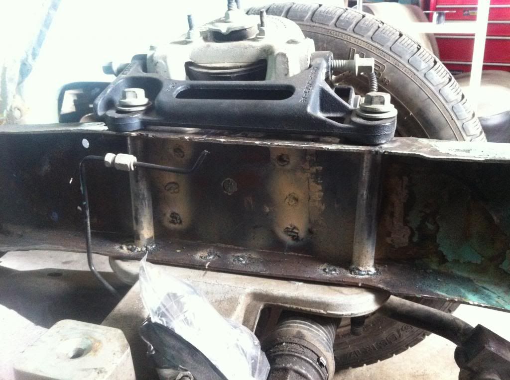

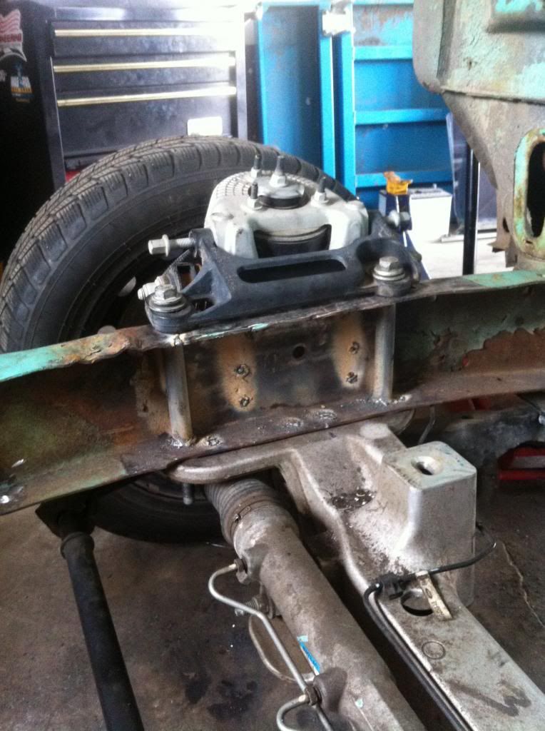

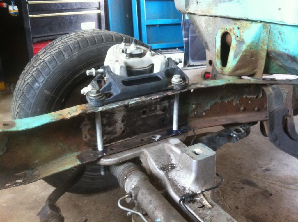

Here is where my Centerline ended up. Not too sure if thats right, haha but it looks great holding the fender up
[IMG]<a href="http://s1172.photobucket.com/user/cccreations1/media/005_zpsa583fcde.jpg.html" target="_blank"><img src="http://i1172.photobucket.com/albums/r567/cccreations1/005_zpsa583fcde.jpg" border="0" alt=" photo 005_zpsa583fcde.jpg"/></a>[/IMG]
[IMG]<a href="http://s1172.photobucket.com/user/cccreations1/media/006_zps008468e6.jpg.html" target="_blank"><img src="http://i1172.photobucket.com/albums/r567/cccreations1/006_zps008468e6.jpg" border="0" alt=" photo 006_zps008468e6.jpg"/></a>[/IMG]
[IMG]<a href="http://s1172.photobucket.com/user/cccreations1/media/007_zpsa139c1b9.jpg.html" target="_blank"><img src="http://i1172.photobucket.com/albums/r567/cccreations1/007_zpsa139c1b9.jpg" border="0" alt=" photo 007_zpsa139c1b9.jpg"/></a>[/IMG]

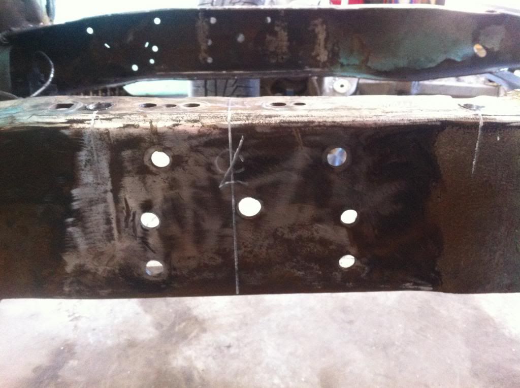

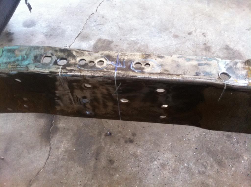

IFS drilled and bolts just set in
[IMG]<a href="http://s1172.photobucket.com/user/cccreations1/media/010_zpsfaf49749.jpg.html" target="_blank"><img src="http://i1172.photobucket.com/albums/r567/cccreations1/010_zpsfaf49749.jpg" border="0" alt=" photo 010_zpsfaf49749.jpg"/></a>[/IMG]
Then got down to fitting the sleeves in. Used 5/8" ID thick walled tubing and filled the rivet holes in
[IMG]<a href="http://s1172.photobucket.com/user/cccreations1/media/014_zps14a9a188.jpg.html" target="_blank"><img src="http://i1172.photobucket.com/albums/r567/cccreations1/014_zps14a9a188.jpg" border="0" alt=" photo 014_zps14a9a188.jpg"/></a>[/IMG]
[IMG]<a href="http://s1172.photobucket.com/user/cccreations1/media/013_zpsfc762798.jpg.html" target="_blank"><img src="http://i1172.photobucket.com/albums/r567/cccreations1/013_zpsfc762798.jpg" border="0" alt=" photo 013_zpsfc762798.jpg"/></a>[/IMG]
