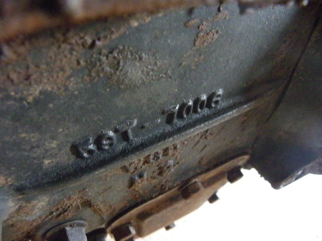

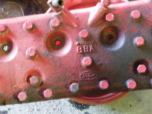

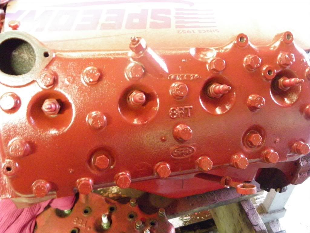

8RT is the designation for the truck engine. 8BA is the designation for the car engine. If you have the 8RT heads, wide fan belt setup with truck pumps, and the oil pan with the clean out you have a truck engine. That said, all those parts swap with the car engine too, so you can find pretty much any combination these days.

ALBUQ F-1 has a spectacular reputation.ALBUQ F-1 has a spectacular reputation.ALBUQ F-1 has a spectacular reputation.ALBUQ F-1 has a spectacular reputation.ALBUQ F-1 has a spectacular reputation.ALBUQ F-1 has a spectacular reputation.ALBUQ F-1 has a spectacular reputation.ALBUQ F-1 has a spectacular reputation.ALBUQ F-1 has a spectacular reputation.ALBUQ F-1 has a spectacular reputation.ALBUQ F-1 has a spectacular reputation.
Quote:
Originally Posted by fordf5 View Post
The whole engine was very clean. I pulled the oilpan because the PO said there was some sludge that he got by sticking his finger in the drain plug hole when he drained the oil. Not really very much though. And Im thinking this is a truck engine.
He said the PO before him said it was a 51, the oil pan is just like the one from my orig engine and the intake has the extra vacuum port.
If so, how lucky can one be??? This all started from a chance meeting at the parts store...
........Roger
Look on the back of the block, just to the right of the oil pump drive gear cover. Is there a 0BA or 1BA cast into the block?
I can't tell if there are hardened seats or not, but the valves and springs are 8BA, not the '51-on rotator type. But it could be a '51 block that was retrofitted with earlier springs and valves. If the heads are still off I'd check for hardened seats for sure.
The 8RT heads are generally lower compression than 8BA, do you have another 8BA head so they match? (off old engine)

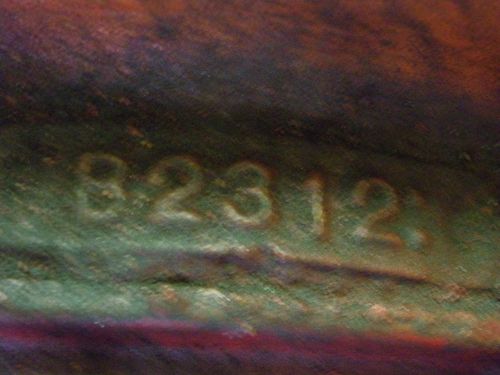

One step forward two steps backward but nonetheless progress is being made.
.Factory markings while in it's infancy?
.transmission markings
.lookin a little better
.puttin the two together
.ahaaa Sweet success
