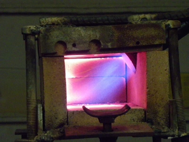

  #74
Old 03-24-2014, 07:21 AM
fordf5 fordf5 is online now
Join Date: Mar 2014
Location: Nelsonville, Ohio
Posts: 169
fordf5 is starting off with a positive reputation.
One thing that I do not have is a set of torches.
My only heat source is one I built for making knives.
It will do the job for smaller fabrication but not for loosening stubborn bolts.
I made these from discarded files.
The copper bolsters are from an electric buss-bar.
Walnut handles are from a tree that blew down many years ago.
Reply With Quote
  #75
Old 03-24-2014, 07:38 AM
harleymsn's Avatar
harleymsn harleymsn is offline
Join Date: Dec 2001
Location: Crossville, Tn
Posts: 3,351
harleymsn is a name known to allharleymsn is a name known to allharleymsn is a name known to allharleymsn is a name known to allharleymsn is a name known to allharleymsn is a name known to all
Beautiful use of heat, I am jealous.
