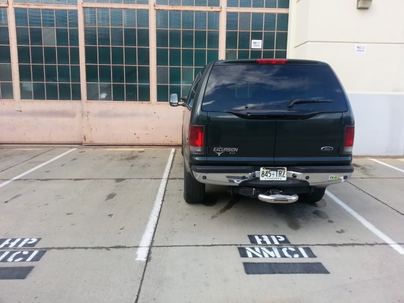

got some goodies today. still waiting on more parts though
Quad Shock perches and new sway bar bushings
and a better view of the tires
I like how the tires sit flush. I'm likely to end up buying spacers and flares...but for now it looks very nice

Some of the pics are in front of my house on Ford Island, and some of the pics are from an Aircraft hanger on the other side of Ford Island. The Navy has really built up the island in the last few years. I can barely remember it from 2002 to present. I imagine the difference from 80's/90's is that much more dramatic
