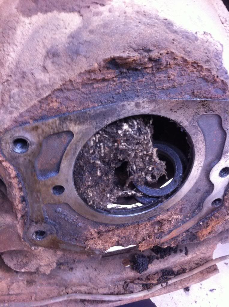

New slave cylinder didn't help, so I went ahead & tore into it. Got the starter out & look at this *****: HUGE rats nest in my bellhousing!
Some pics with the trans pulled:
[URL=http://s1107.photobucket.com/user/Byrd_Dog/media/RMBiPhonepics024_zpsc313b646.jpg.html]
Have to say that removable panel over trans is handy as hell!! 4 bolts hold the trans on the bellhousing, & once they're out, trans just slides right out.

Clutch & flywheel actually look alright, but I'm gonna take it all apart to clean it up real good. If I post a couple pics of the clutch, can anyone tell me if it still looks good? The throwout bearing came out with the trans, & it seems to be worn out.

Anytime Ive ever done a clutch and pressure plate change out I replace the throw out bearing. You hate to put it all back together and then start having problems there. Might as well replace it while its apart.

This times a bazillion. You're there, get a clutch kit and be done with it for another 100K miles (5 miles if you ride the clutch). If it were me, and I'd already done the slave, I'd get a rebuild kit for the master or even replace it if needed. The master isn't subject to things like water, salt spray ( and rats!). So it may be OK. but there's the piece of mind thang that comes into play

I also had a rats nest in mine as well. I have the inline 6 so my clutch is a 10" I only figured it out after the 11" didnt fit and had to sentit back.

Interesting. The T98 I got came with a 223 out of an F350(?) and it had an 11". It too was filled with rodent bedding. I did replace do a clutch kit because I overhauled the engine and am doing the trans, just cuz it's out and I ain't never overhauled a trans.
