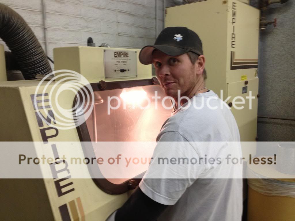

Did some more work on front suspension today. Headed over yo my buddy's dad's shop for some bead blasting and hydraulic press for new bushings in the control arms. Here's the shop
Me blasting the control arms
