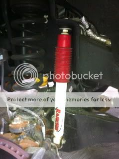

Got my Bilsteins 5100's today. Installed them in about 2 hours, not bad for never replacing shocks before. I did watch the video from BigSarge who did the same thing to his diesel, lots of help with some of the little things on the front install to make it easier. They went right on with no effort at all, perfect fit and replacement for the FX4 Rancho's.
Took the Rancho's off and was able to push them all the way down very easily, and they took about 2 minutes to fully extend. The rear shock's were even worse, they would not extend without me pulling the out.
The new one's are a very nice silver with a closed rubber boot on them, they also came with all the hardware needed to install the fronts, the back were a direct replacement with all the same bolts.
The truck is not so bouncy any more, a little smother ride too. But I only drove about 5 miles so far, I will know more when I am able to drive a little further and find some roads with more potholes (not hard here in MI).
Here are some pictures:
Stock shocks with hard plastic boot not protecting anything and allowing dirt to get to the piston, the Bilsteins have a sealed boot.
Click the image to open in full size.Click the image to open in full size.
Here is a picture of the rears, stock have no boots at all:
These are the ones that came off:

Looks good, How many miles were on the ranchos?

I have 8860 miles on the truck. At first I just assumed that was the way it is supposed to be, a little bouncy, it's a truck after all. It's not anymore and rides good now. BigSarge changed his at 2900 according to his video.
