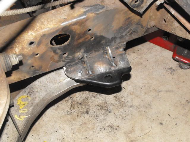

Tranny cross memeber i fabbed
Click the image to open in full size.
Lower control arms mount
