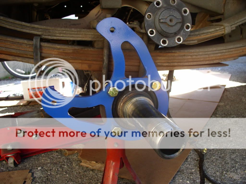

I still prefer my homemade weld on style ones! This way I could clock it to any position to be able to bleed all the air out for my application.

73 Ford guy I seen the pics you posted in the one lift thread great truck. the brackets that are in the link above bolt at the backing plate am I correct? Couldn't I spin the brackets to where I want them and weld them on instead of bolting them in place?

The bolt hole pattern clocks the bracket at a 45 degree angle atop the axle, but you can also weld them if you prefer a different position or for added strength.

In your case if you had bolt on brackets I would slot the holes to where you need the caliper sitting then bolt and weld it. Just remember if you ever need to tilt your diff up towards your t case down the road for a cv driveshaft you will need to re locate the caliper so it will properly bleed and get the air out. I did both at once cv shaft, rotating up, then got an idea where the caliper needs to sit , so weld on style is nice..
If you chew up ujoints due to extreme angle a cv shaft is a must!

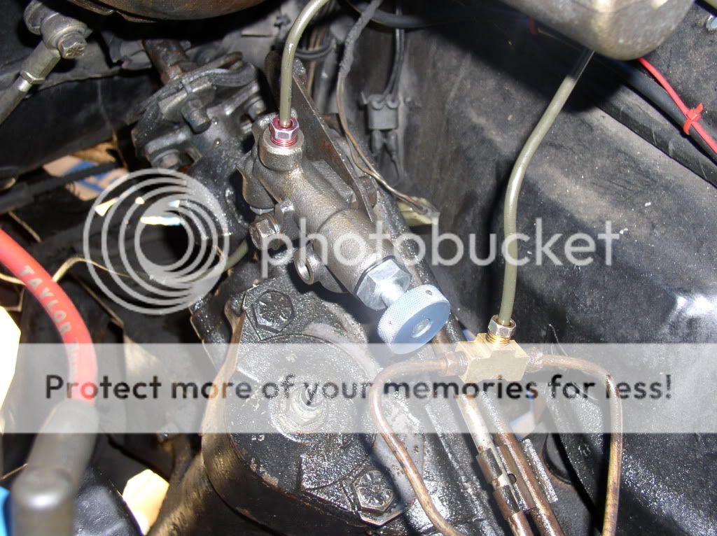

You might also want to think about installing an adjustable proportioning valve.
