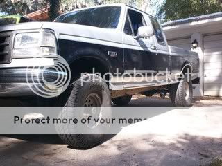

The Man posing for a couple pics after I went out and gave him a nice breathing session after sitting for a week and half.
My bumper is bent i know. i need to find a new one
