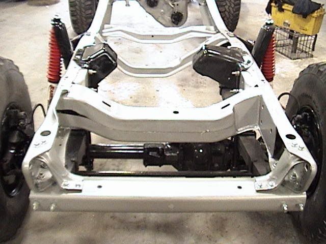

Those perches from ebay looks like the ones I have in my truck and they are for a 351M/400, cuz that's what was in my truck.

Fordification's page on engine perches must be wrong then... how do these perches mount to your frame if you don't mind showing or explaining. I don't think I could even get these to mount to my frame if I wanted to as I believe the crossmembers must be different between the 2WD and 4WD.

My truck is a 77 F250, but uses the later perches for the 351M/400
I didn't have an above view of the drivers side, but here is the passenger side.
Frontal view

Awesome pictures. Indeed those are the perches I have.. my 2WD is different the perches are mounted to the crossmember.
