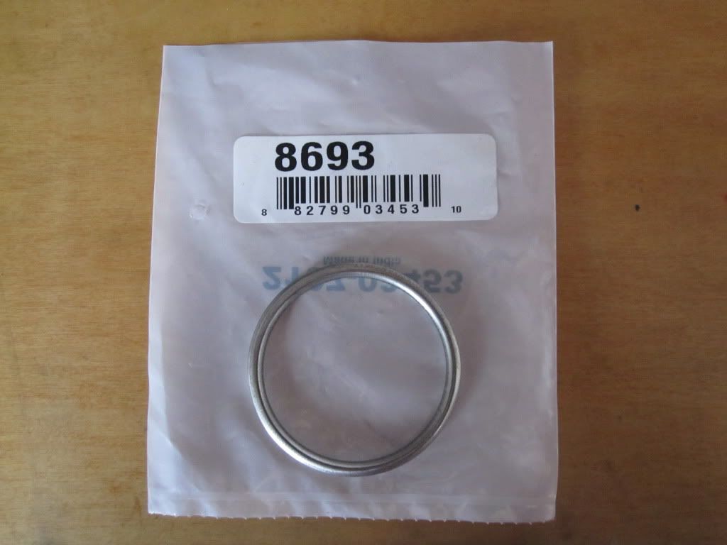

I had the same problem after taking my exhaust manifold off to drill it for and EGT probe. I tried 4 different times to get it mated up, Ypipe first turbo last, turbo loose, manifold loose y pipe next, it did not matter how I did it. Eventually I over tightened the bolts to the point of bending the clamp on the y pipe, after that I really became frustrated. I replaced the y pipe because of the bent clamp. I still had a leak. The only thing I could figure was the exhaust manifold was out of round and I was too cheap to buy one. So finally I went down to the local muffler shop and gave them the inside diameter of the exhaust manifold and the outside diameter of the flare on the up pipe. I told him I wanted a metal crush gasket about 1/8 inch thick a hair bigger than the inside diameter of the manifold. He looked it up gave me a part number and sent me to Carquest to pick it up.
10,000 miles still no leaks. I actually just checked it again about 2 weeks ago. It may not be the recommended way but it is working great.
Sorry I cannot find the part number for the gasket or I would give it to you.

Found the bag. AP Part number was 8693
Here is a link to one from a web based vender.
AP EXHAUST Part # 8693

Installed the gaskets today and they helped with the exhaust leak. Should add post to the tech folder. Here are some pictures:

Glad it worked for you. How did you get the picture? I could barely get on hand up there while trying to get the o-ring in place with the other.
